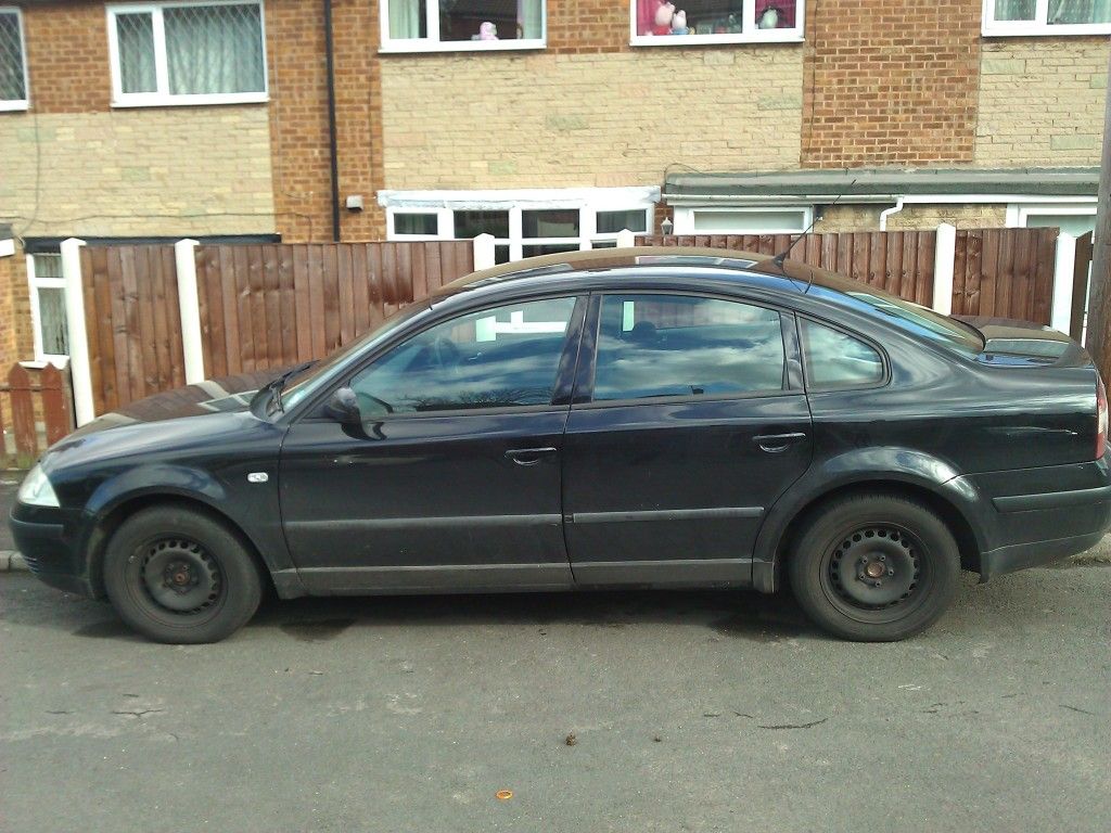

A 1.9 tDI B5.5 130ps bought in January 2012 with 92,000 miles, FVWSH and new clutch but the daft woman who had it before me never had a cambelt change so that was first thing (was crackin all the way round so was very lucky) the car was tidy as hell, couple of scratches that will be easy to sort, no visible rot (touch wood) and no dents, fairly clean interior but could do with seats cleaning.
Was rather cheap and I found out why on the way home from manchester to rotherham where i live, turbo kept cutting out and going into limp mode so after getting a vag-com cable and loads of help from Desertstorm we found it to be the MAP sensor so a quick trip to Darkside Developments in Barnsley and £25 later the car was flying down the M1 back home, dealer thought turbo was F****d so he sold it cheap, cost me £25 to put right - WIN!

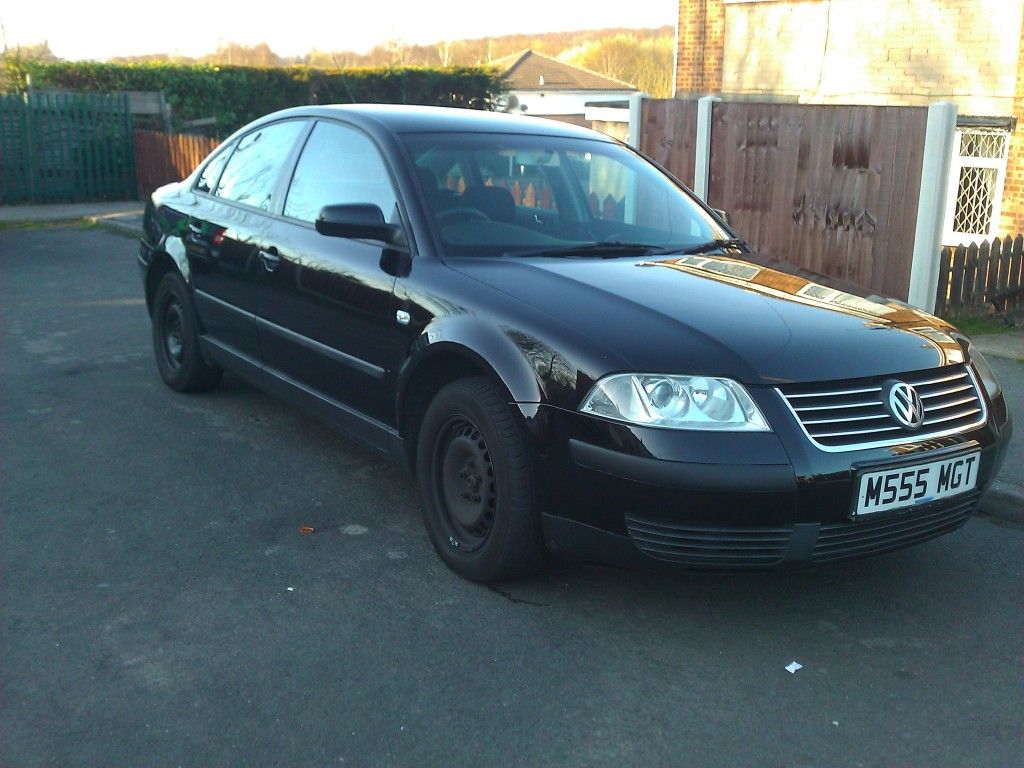

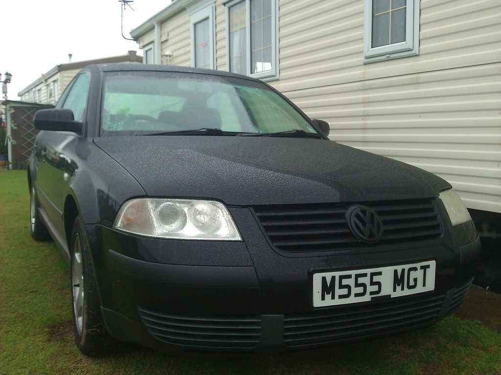

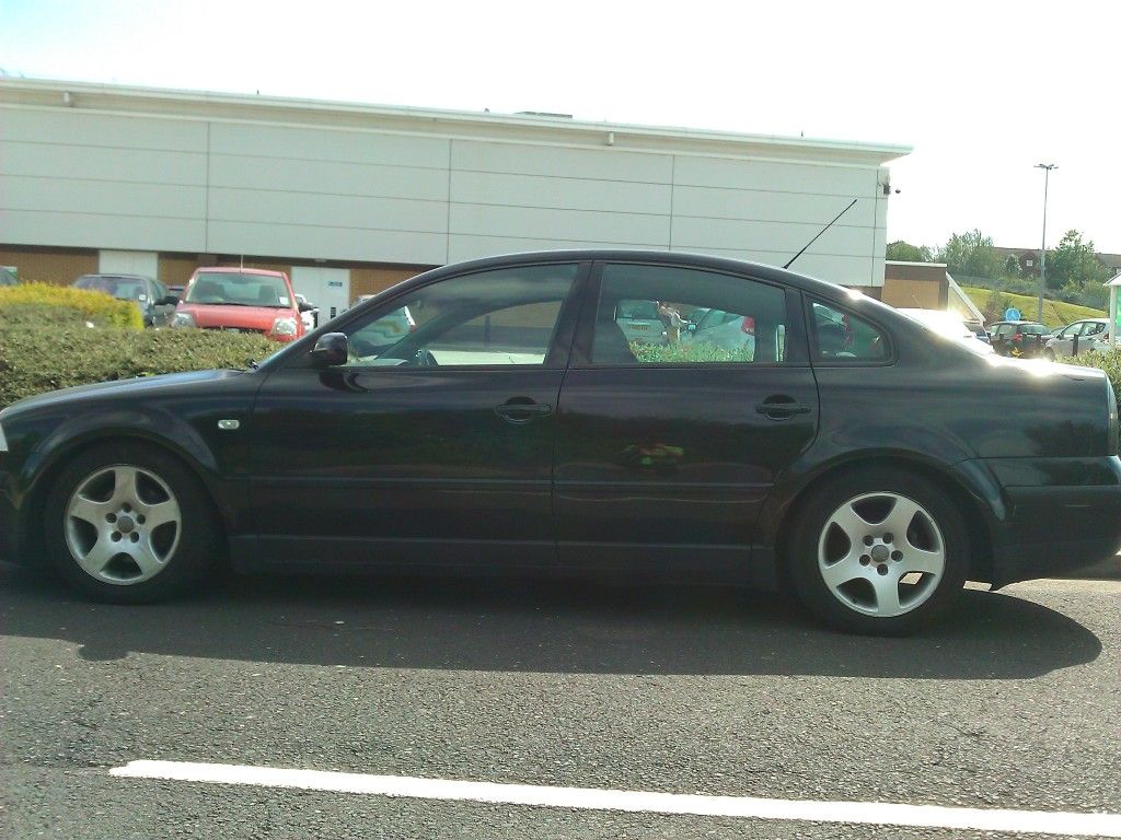

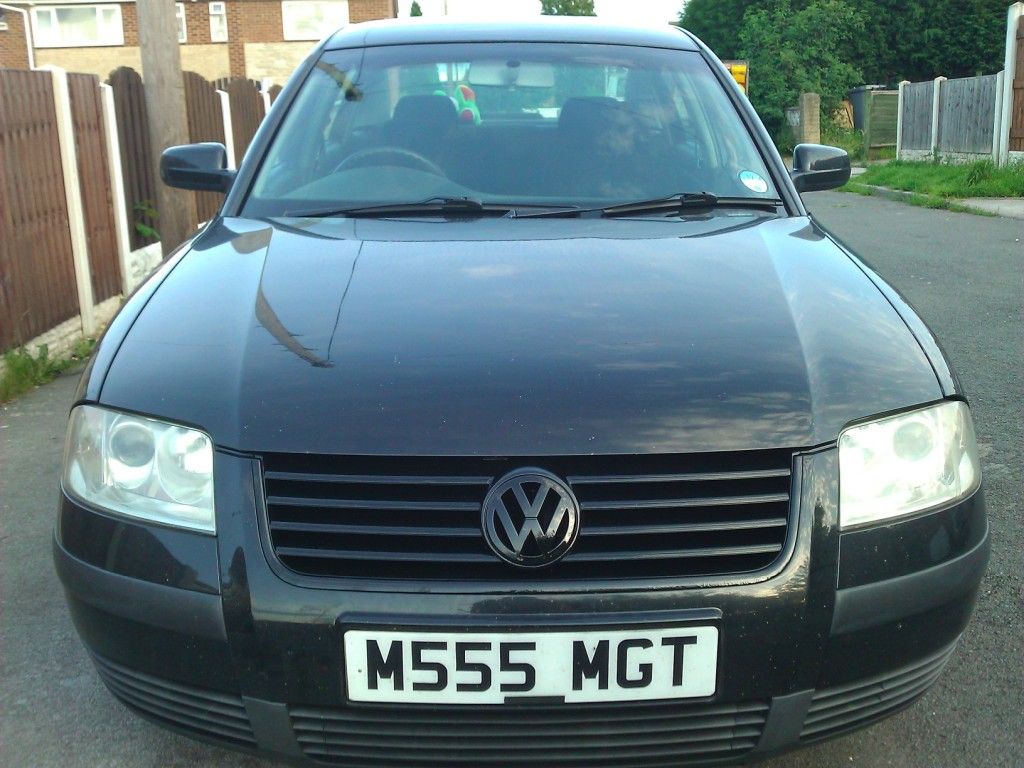

Heres what she looked like when I first bought her

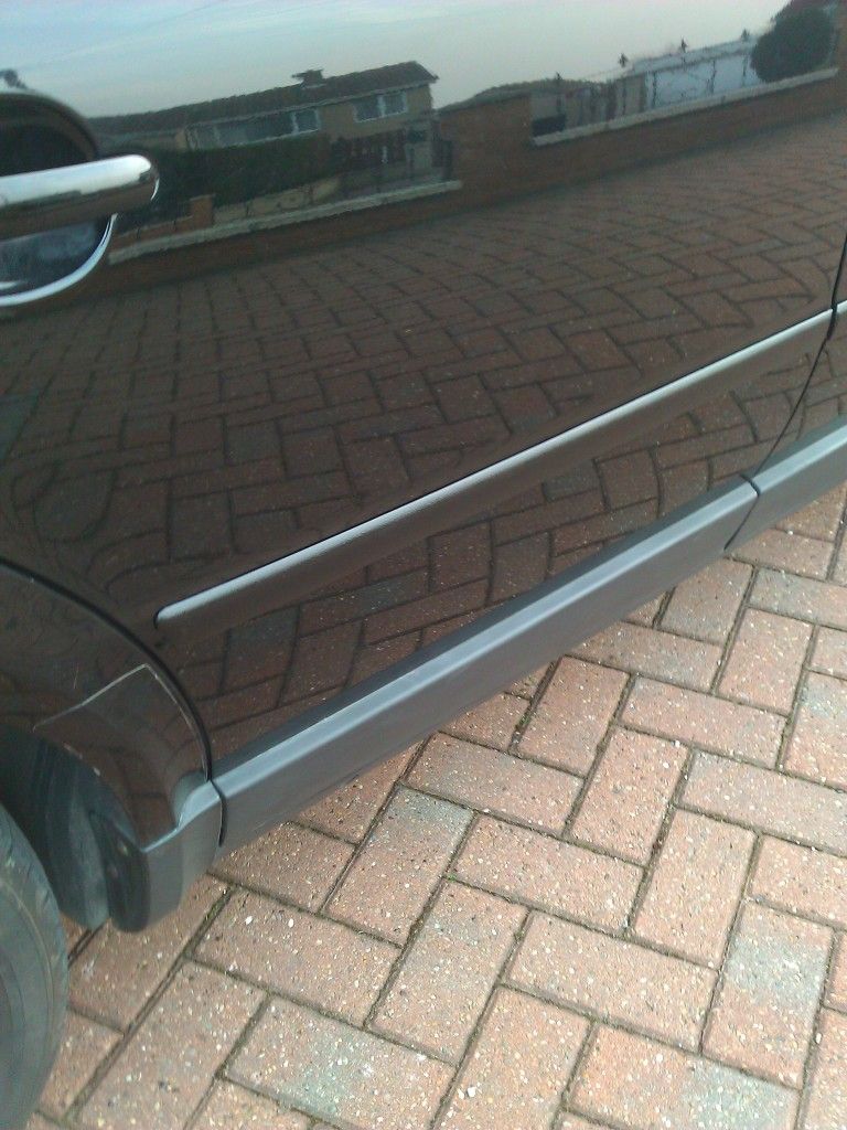

Then I sprayed the door strips black as they were looking a tired grey

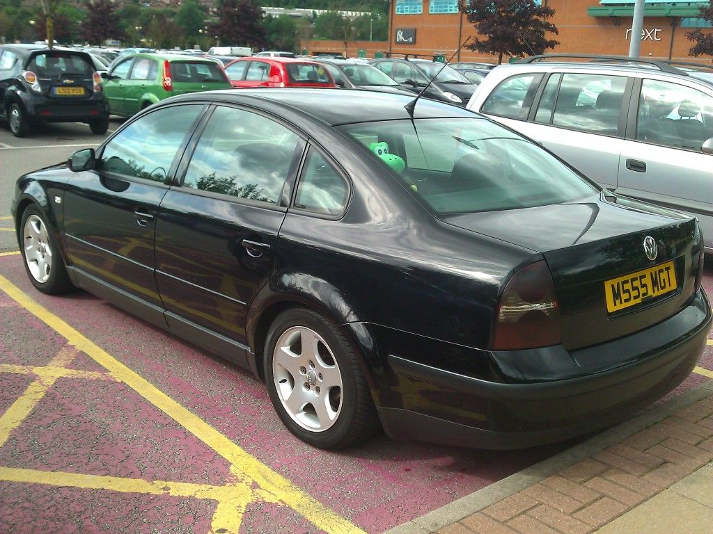

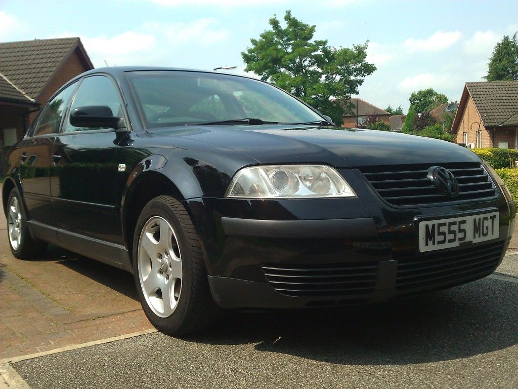

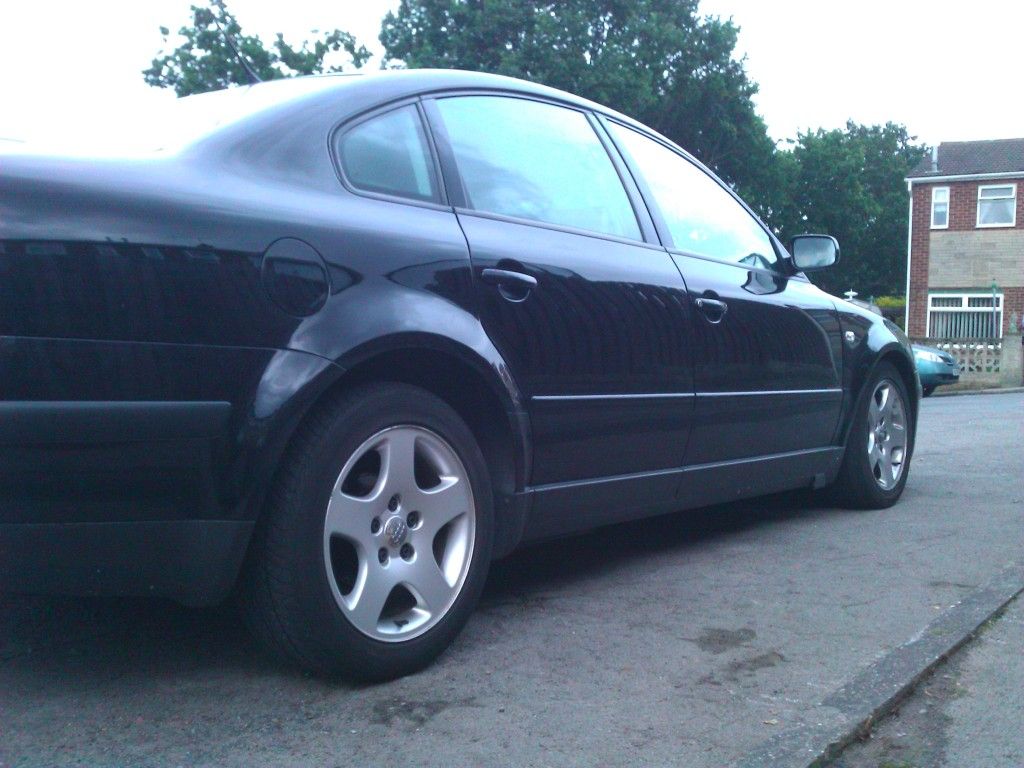

Then got a good deal on some 16" audi a4 wheels (sset of 5 with good tyres) £100 just to put me on until I get some 17's or 18's

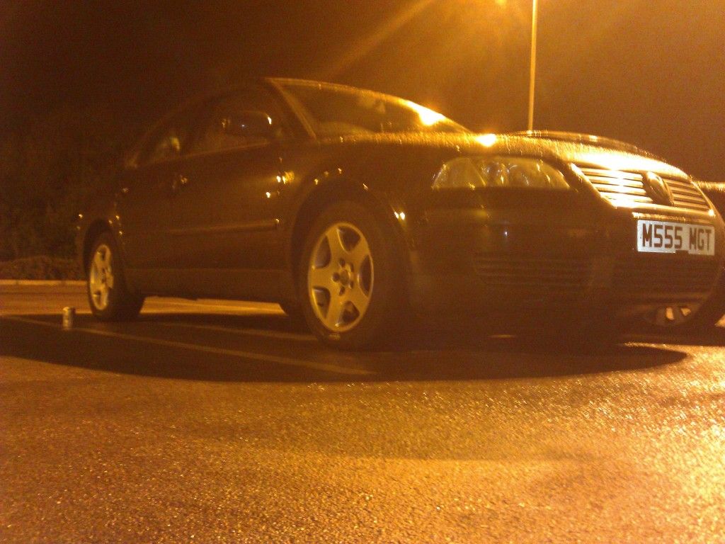

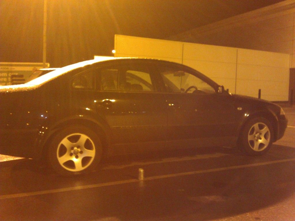

A few night pics

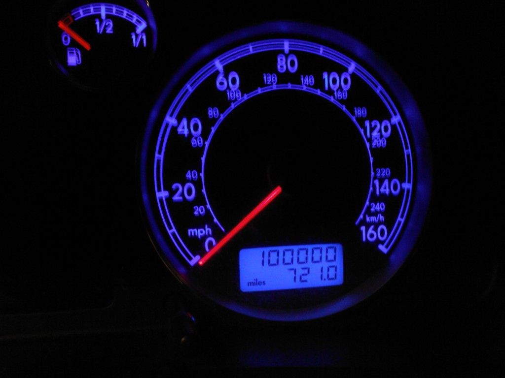

The day she clocked over to 95,000 miles

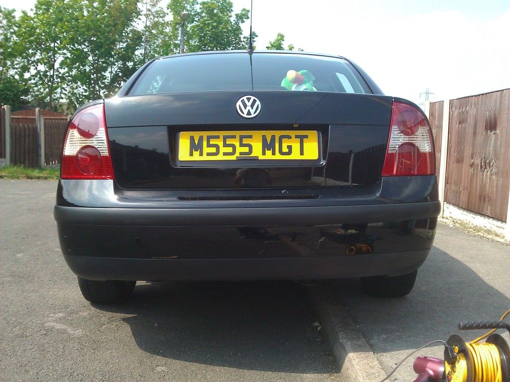

Then it was time to debadge the rear
Before
And after
I also took the VW badge off, took it apart and re-sprayed the backing in black as it was looking a tired grey like the other plastics on the car lol

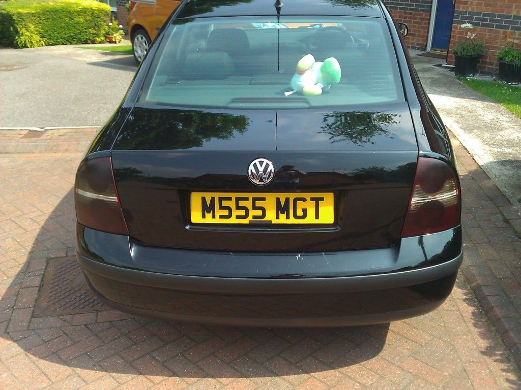

First of all, tinting the rear lights, E-tech lens spray (about £5 off ebay)
during the job (had an idea hence the electrical tape :wink: )
Fitted to the car - they need to be a bit darker imo to make the clear strip in the middle more effective

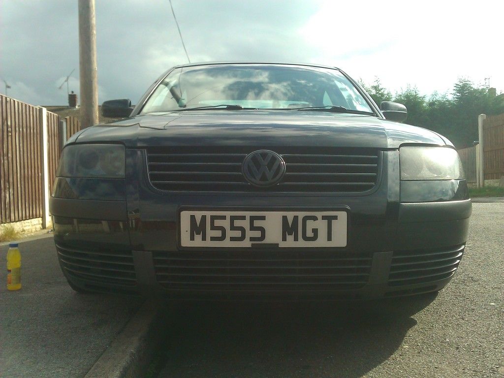

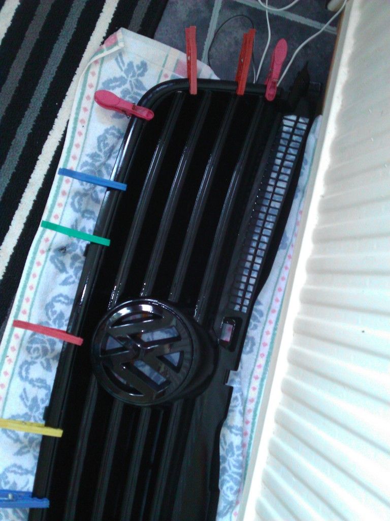

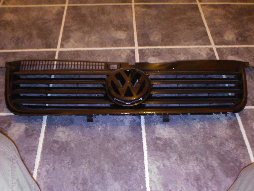

Then a new front grille was sourced, same as my standard one but I didn't want to ruin
mine so bought this to have a go with -
Sprayed up black and fitted back to the car -

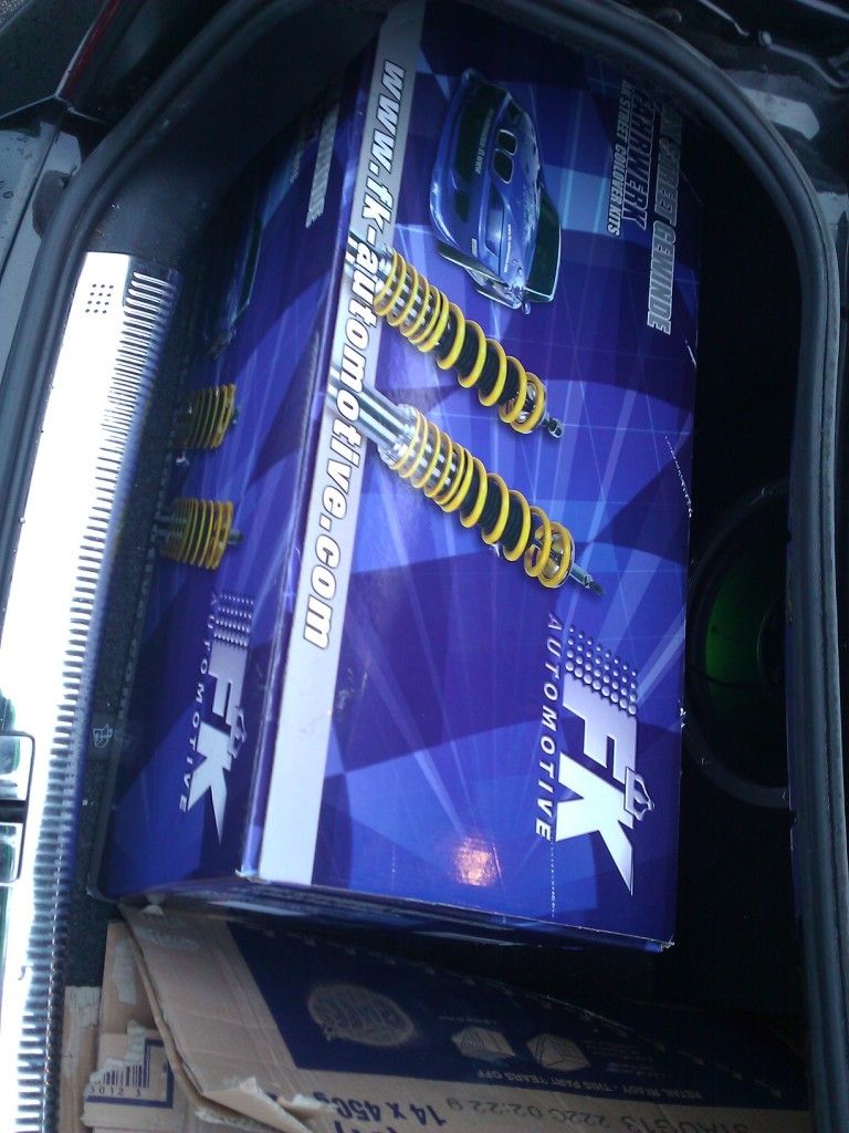

got an awesome deal on these brand spankin new FK Coilies, £100 - jobs a good un!

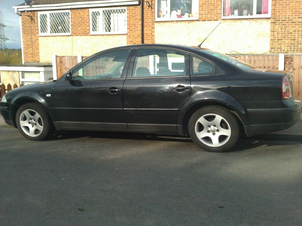

So a couple of weeks ago the weather wasn't bad and in the space of about 6hrs
(pathetic I know lol) I managed to fit the fronts only lol, main reason
being I was windin the nut the wrong way so it just kept goin lower
(it was already too low when I first put it back on the ground)

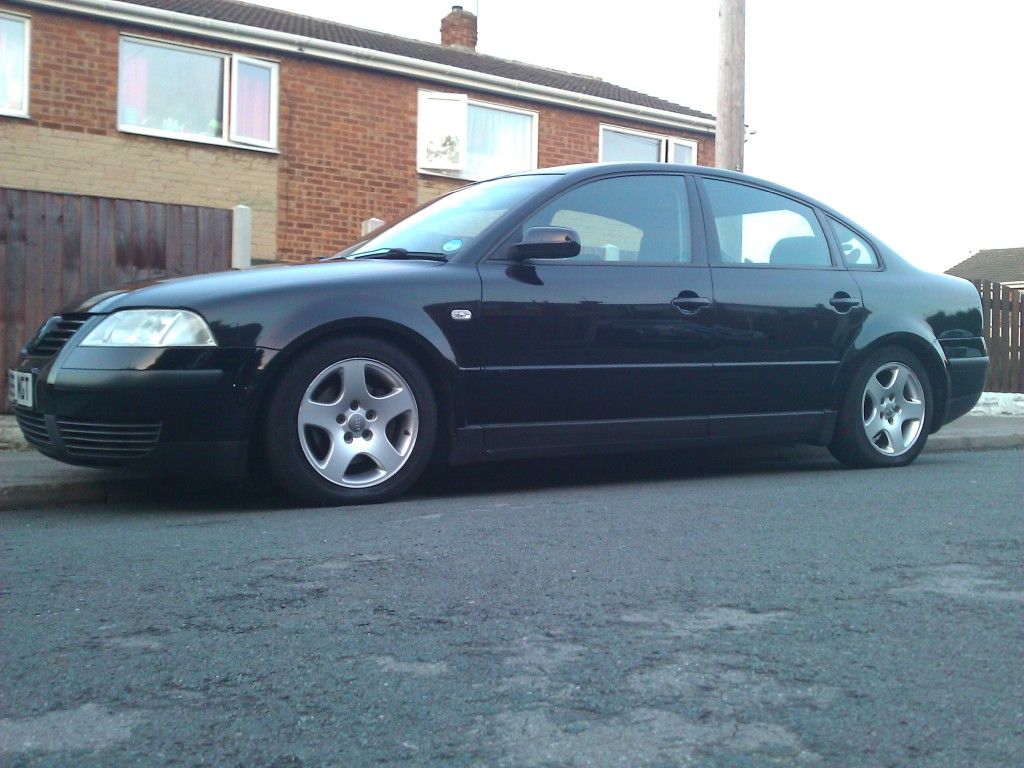

but I realised my mistake and wound it up a bit :
Then on Tuesday I managed to get the rears done and she was sittin ok :
After a bit of driving she settled in a bit more :

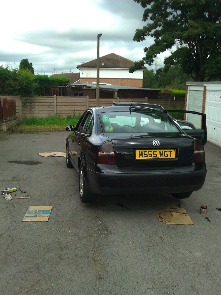

Had a bit of a disaster a couple of days later, was outside lowering the rear coilies an raising the fronts and while I was doin the rears I had it up on axle stands with the car in gear but it must not have engaged gear (possibly coz of dmf? not sure) I was jackin the rear hub up to take the weight off the strut and the car decided to move sideways toward me, I shouted the gf to push the car back onto the now 'leaning' axle stands while I put the wheels on as a precaution, then it swayed again and crashed down to the floor wedging the axle stands underneath, luckily no damage was caused as i got the wheels on in time, be it only with 2 nuts but better than none at all. I carried on with the job making sure the car was definitely in gear and locked on the clutch (I stalled it to make sure) but I was very lucky not to have the whole car on top of me crushing my legs under the rear hub x_x
All in all I was very lucky and I realised after that the reason it swayed to the side and not forward is cos I had chocks under the front wheels but the one on the front driver side had moved allowing the front driver side wheel to roll forward.
I'm sharing this as I dont want anyone to have the same problem and maybe not be as lucky as me in the way of damaging the car or even worse, damaging themselves :0
As you can see from the picture below taken after the scary incident, the cardboard was where I was sat at the side of each wheel, which gives you an idea of how much the car moved.
Just be careful

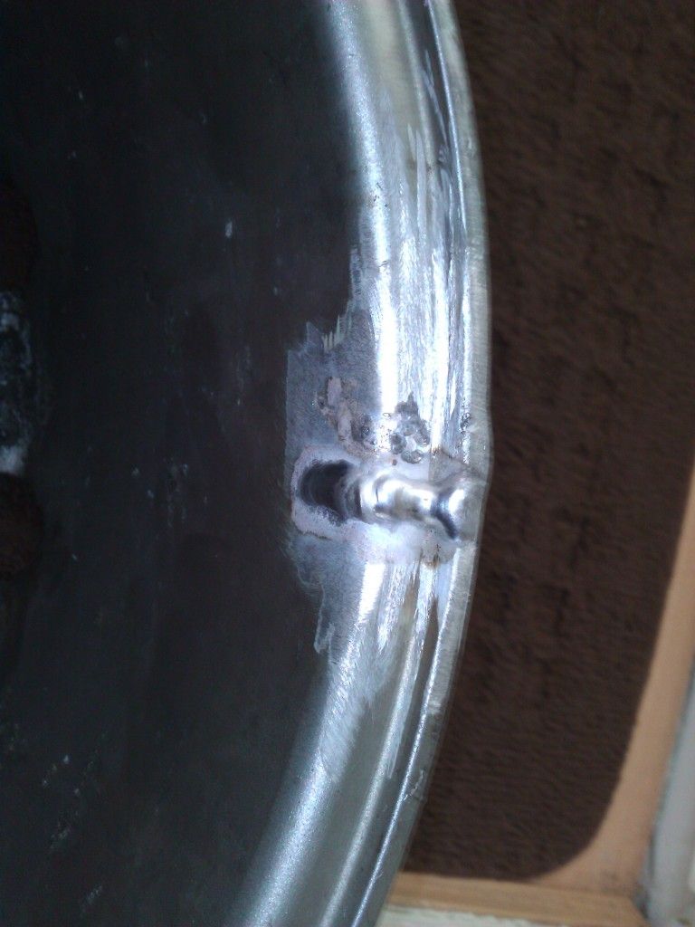

So a bit of an update, was my birthday in September so I treated myself to some wheels for a little refurb project courtesy of G60steve from UKPassats
As said they defo need a refurb as they look like they've been subjected to a cheesegrater attack haha but I wanted to change the colour anyway so it's all good, they have 2 good tyres and 2 will need replacing so I'm on the lookout for some 205/40/17 or possibly 215/40/17 as long as its not gonna mess up the traction control being a slightly different size to the front tyres, they're Rs8 replicas and they need some centre caps too but the price was very fair! As you all know one needed a bit of welding as it had a couple of small cracks but £40 later and a trip to APTyres in Parkgate this was the result - guaranteed too!
