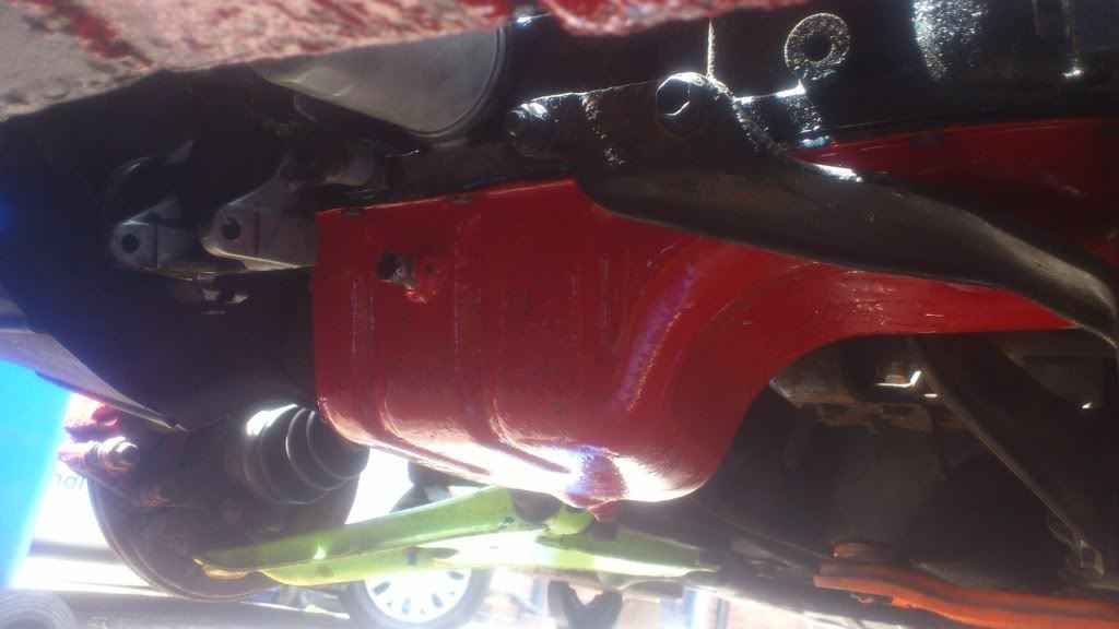

The day began intending to strip a drum, fix a brake cylinder and ended in this
Dropping all the exhaust
Releasing all the handbrake cables
Taking all brake pipes off
Dropping propshaft
Removing subframe
Removing fuel tank
One rear subframe, (diff, shafts, drums ect) dropped and belly fuel tank removed
New subrames being fitted and no brake fluid leaks so far!! It looks so much better without the tank underneath too
Although i do need to modify one bolt for the bottom arm as its spinning at the moment
Hopefully that should solve a few problems

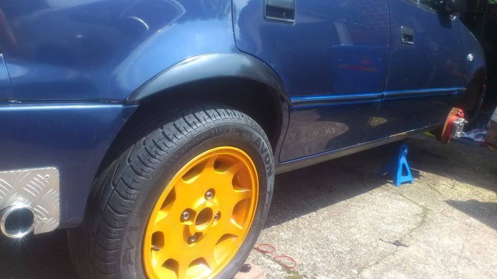

Finally got a spare wheel in
Exhaust looks a load better, chequer plate covers up well
Diff mounts are now 'polybushed' tiger seal works great, also banged abit in the rear engine mount

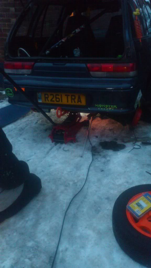

Me fire extinguisher works, hope i dont have to use it for real

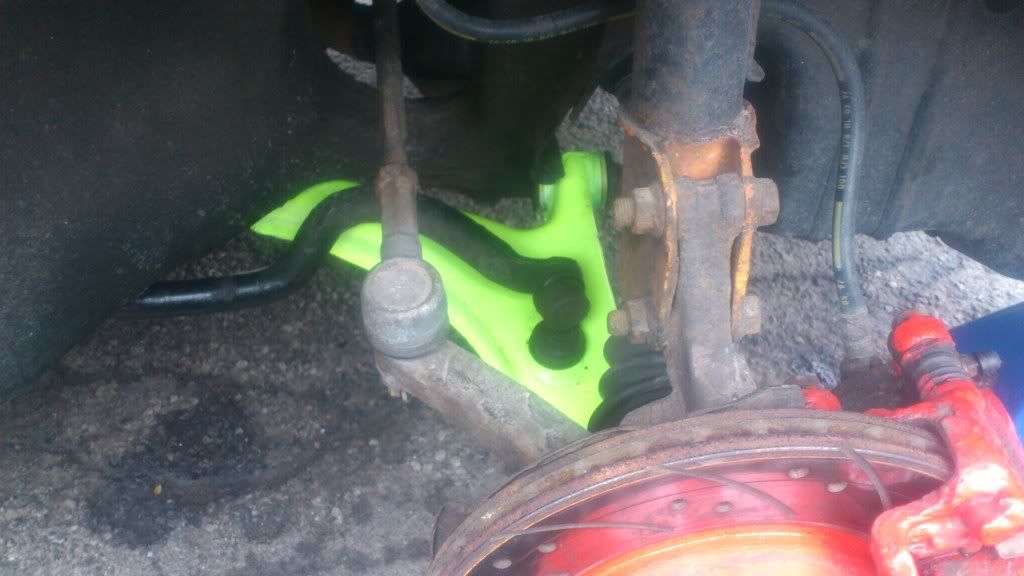

Last mods before the justy gets laid up for some major repairs
My freshly painted new bottom arm
Some arch poke, just need some bolt-on arches now too

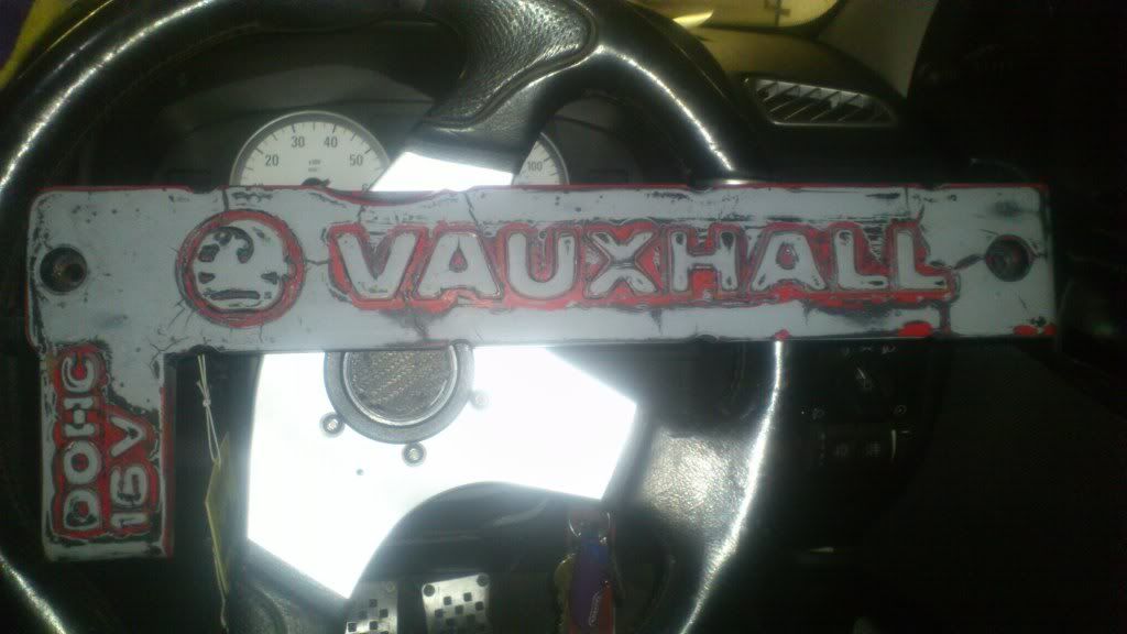

Retop plug cover, from this
To this
To painted DIY colours

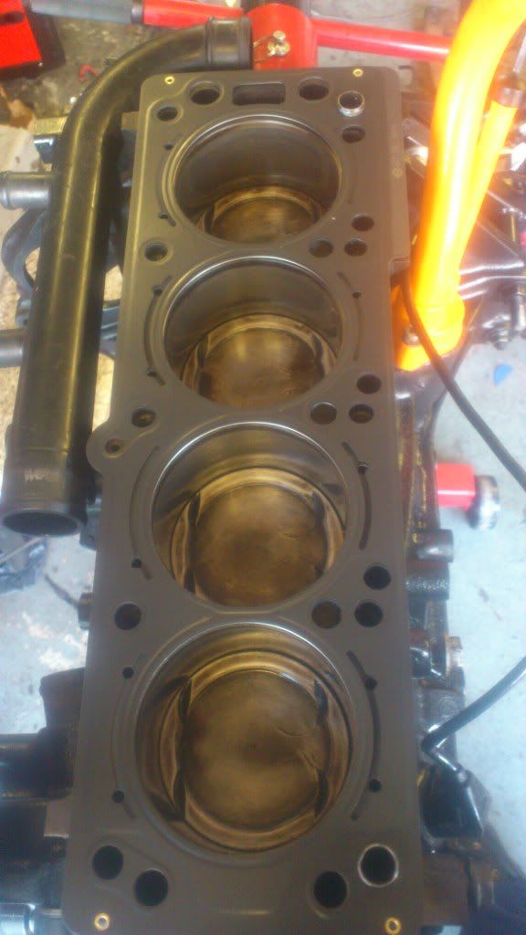

Block all clean with new MLS gasket
Head on with nice clean-ish wirebrushed surface

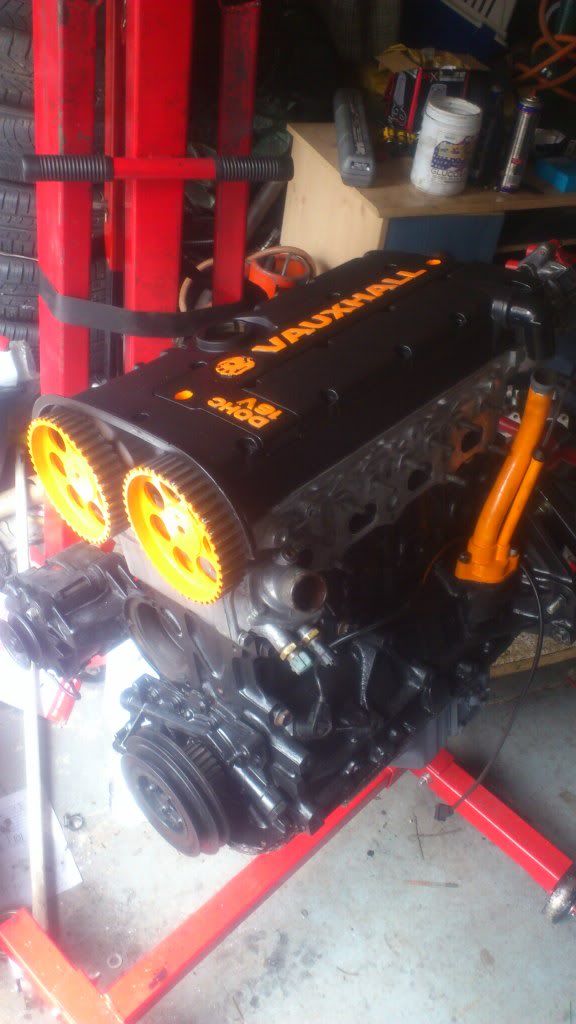

What its gonna look like once ive finished timing it up

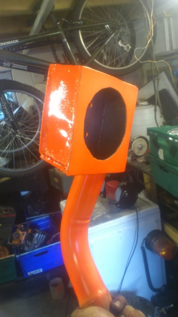

Turbo airbox build
All welded up with nice blueing, no holes fingers crossed

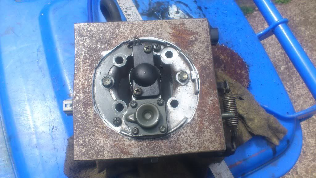

EGR system has been blanked off and thermostat removed for better cooling
Ive also fitted a oil-water cooler to try keep cool for USC
2nd radiator after oil cooler to attempt to lower temps
Intake and DV is on
Sump has oil return fitted
Rising rate fuel pressure regulator is fitted and standard one removed

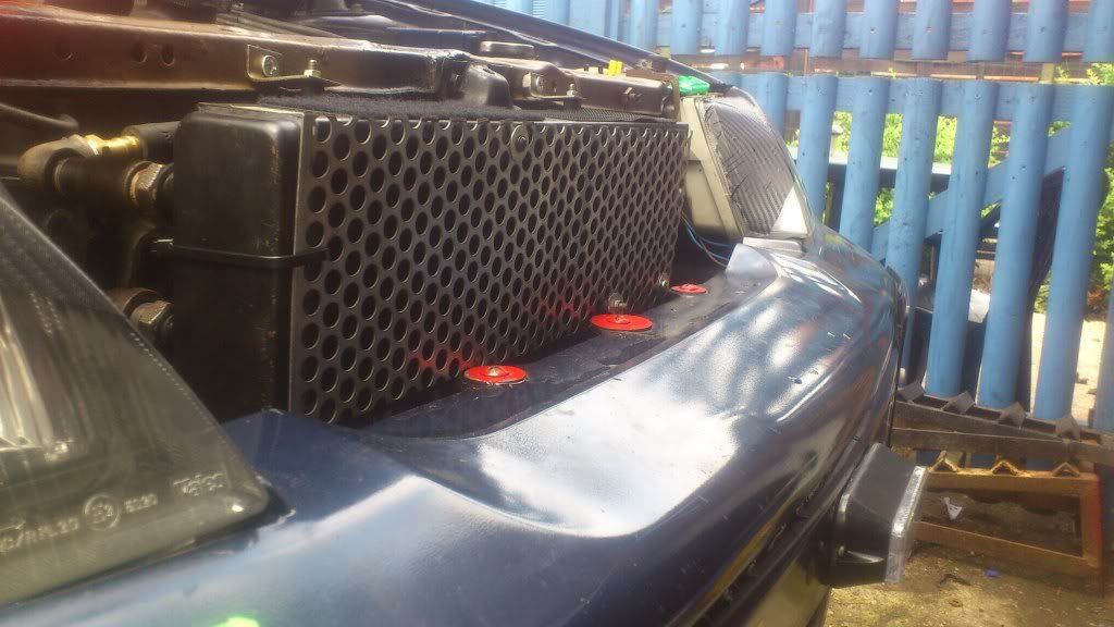

Arch extensions are painted and fitted to cover wide track
Still lots to do before USC hopefully i can get a fuel pump sorted, fit turbo, fit intercooler-piping, door cards, raise bonnet, fit bonnet pins, wire in guages, wire up fan, test and setup turbo fueling

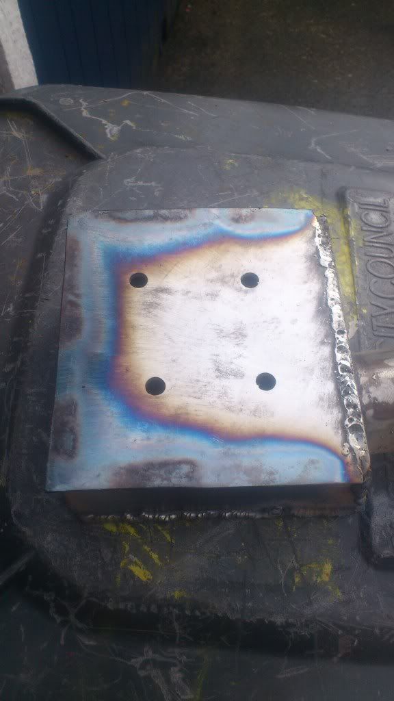

Manifold redesign, people say cast and steel cant be welded, seems to have worked here just hope it doesnt crack
