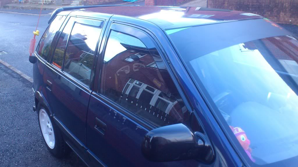

New wind deflectors

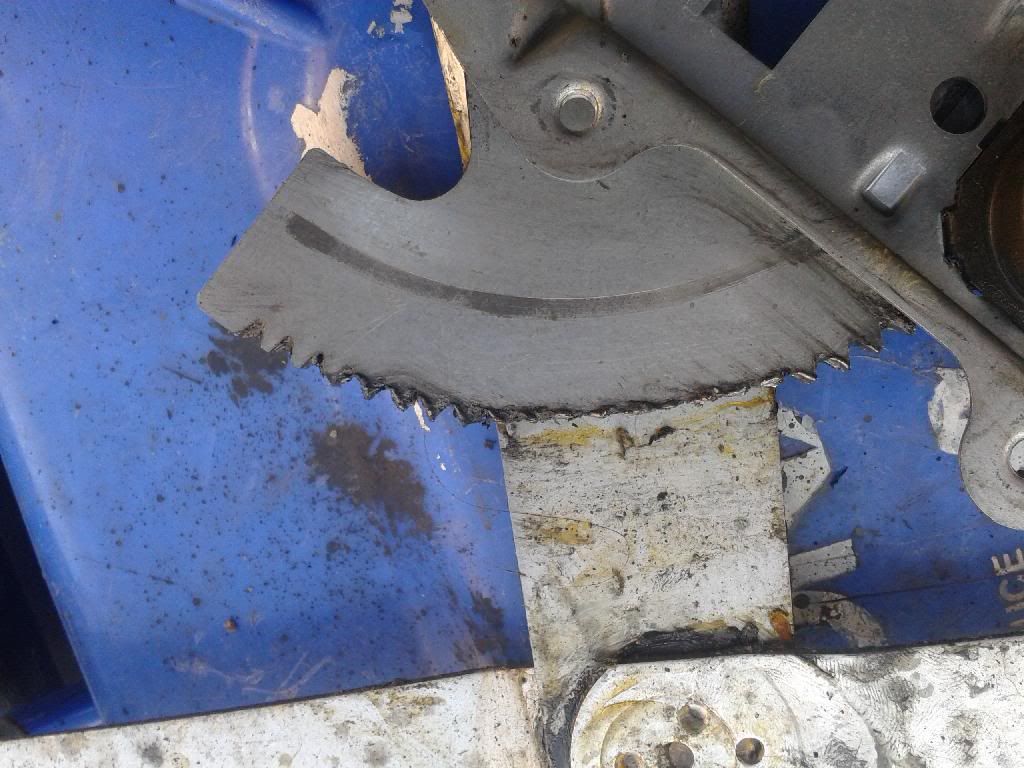

Think ive found my window issues

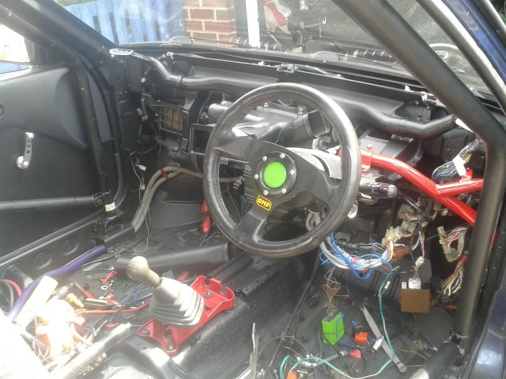

Frames are in and ready for the sidemount fibreglass seats to go in
Looking very bare but light!!

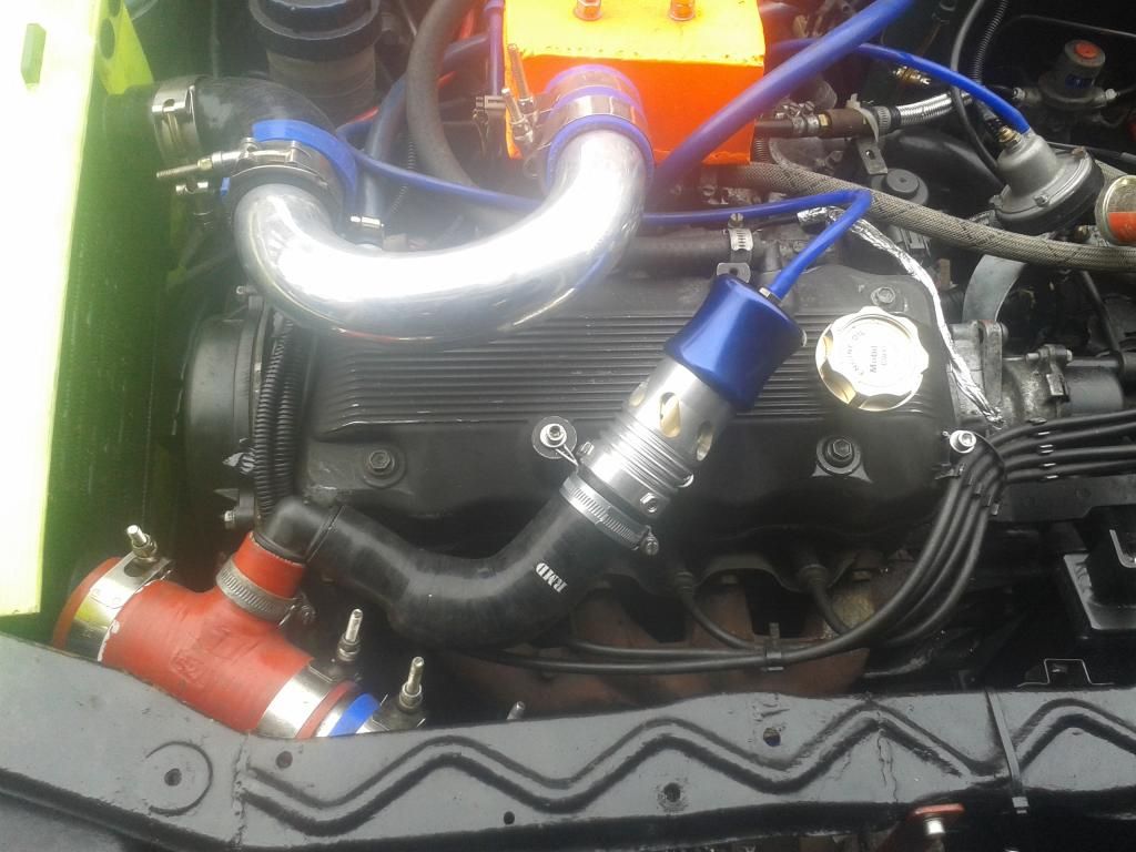

Nice small dump valve, biggers better right???

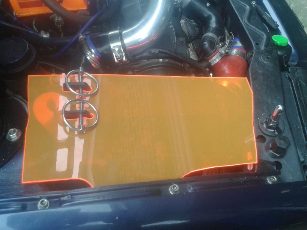

New console
All lit up

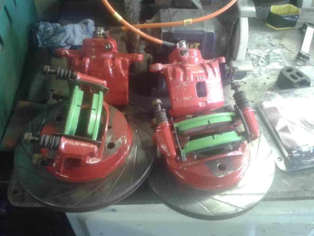

Brakes ready to go on
Brakes are on after some great grinding and swearing, got me nice orange braided lines on too

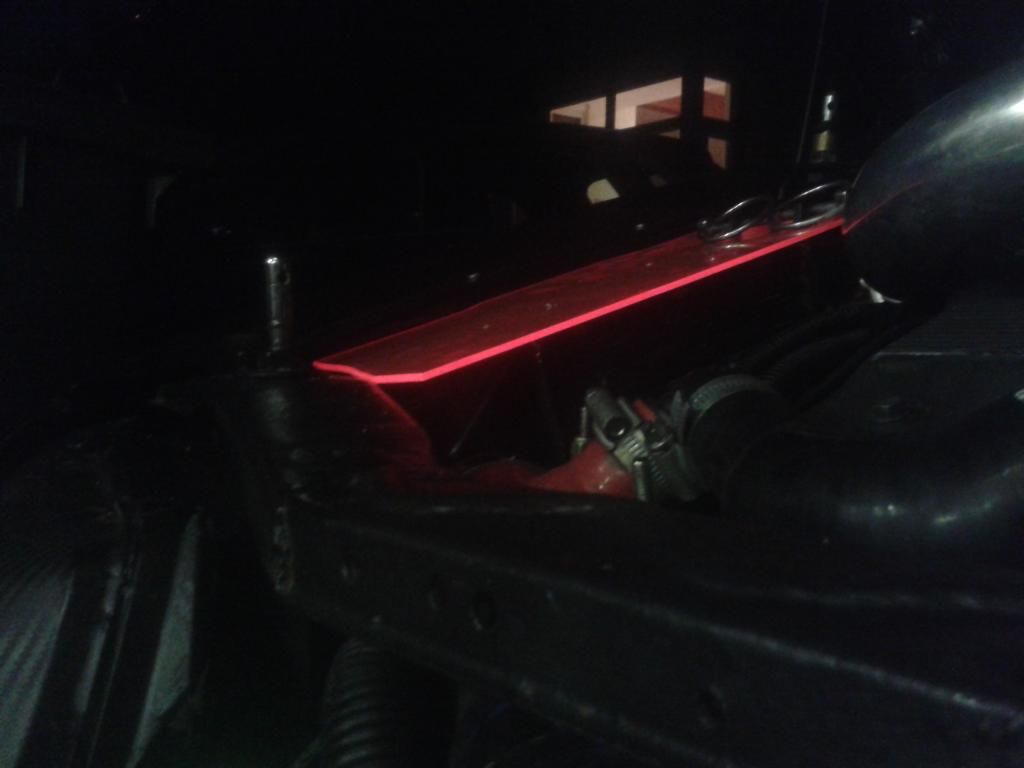

New intercooler airdam
It glows!!!

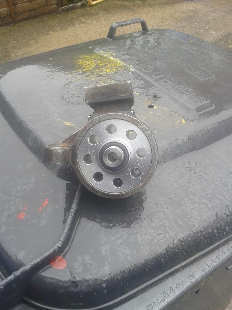

Rear worn bearing removed surprisingly easy with a little hammer persuasion,  no press needed today cheers
