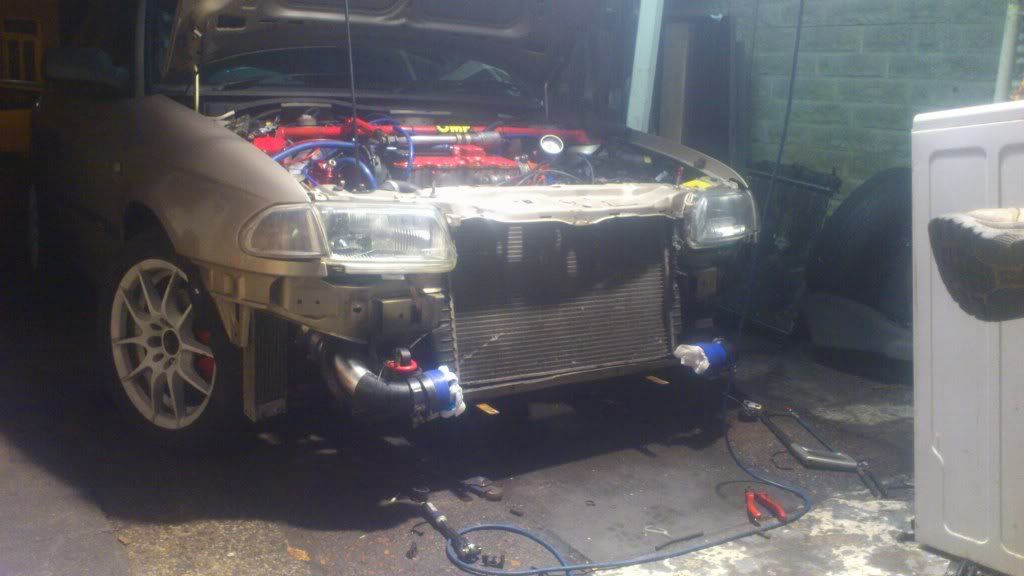

Ha ha, cheers mate, I realy should take more photos of doris when I'm building her, right ...... Over Xmas she's had new shocks all round, modified front springs and short travel rear shocks, she drives amazingly well, handels like a dream, however, allso fitted Polly bush engine mounts, which moved the engine forwards slightly, means that gearbox changes mint between gears, however, the engine moved forward and landed the turbo into the rad, cutting a 3inch slit ......... Bugger, any how, onto rad n.o. 5, this is from an astra mk4 gsi, there is about half an inch between the rad and the schassi legs, so this realy is the biggest that can possibly fit .......... Unless I start to space frame her, LOL alien

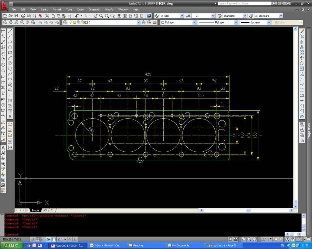

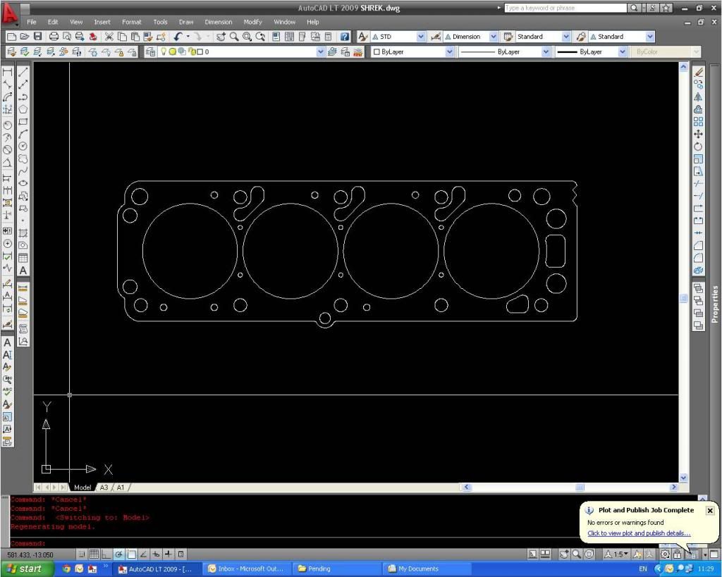

iv drawn this up for ya pal! (not dimensioned up yet)
But not 100% on the dimensions yet as the gasket you have given is not flat and a bit scewed etc!
Any chance on getting some measurements from the actual head one night?
PostSubject: Re: stupid astra   Thu Jan 10, 2013 11:00 pm
Also, are you getting it made at somewhere that can use Autocad files?
As demensioning the beast is a bit messy and confusing (only half dimensioned so far!)

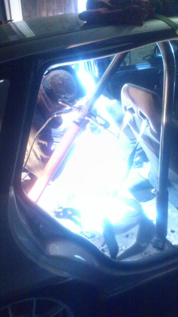

Roll cage modifications
Shreks new in car neon lol more cage mods Razz
More work needed
PostSubject: Re: stupid astra   Fri Jan 25, 2013 12:19 pm
Ooo very cool.. I hope you don't put it to fully use. If you get where I'm going with this.
PostSubject: Re: stupid astra   Sat Jan 26, 2013 6:07 pm
ha ha, cheers for photos tank, i didnt know you took them lol, and yeah, kall, its more to stiffen the schassi and lowwer the centre of gravity, oh, and weve took the sun roof out and plated it alien
