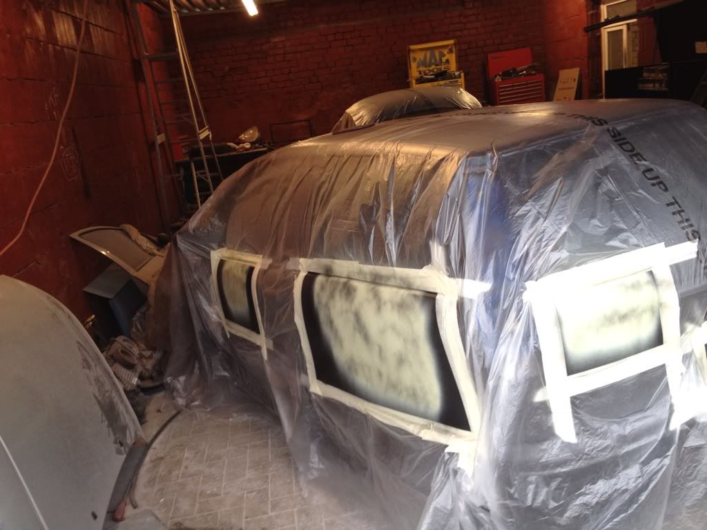

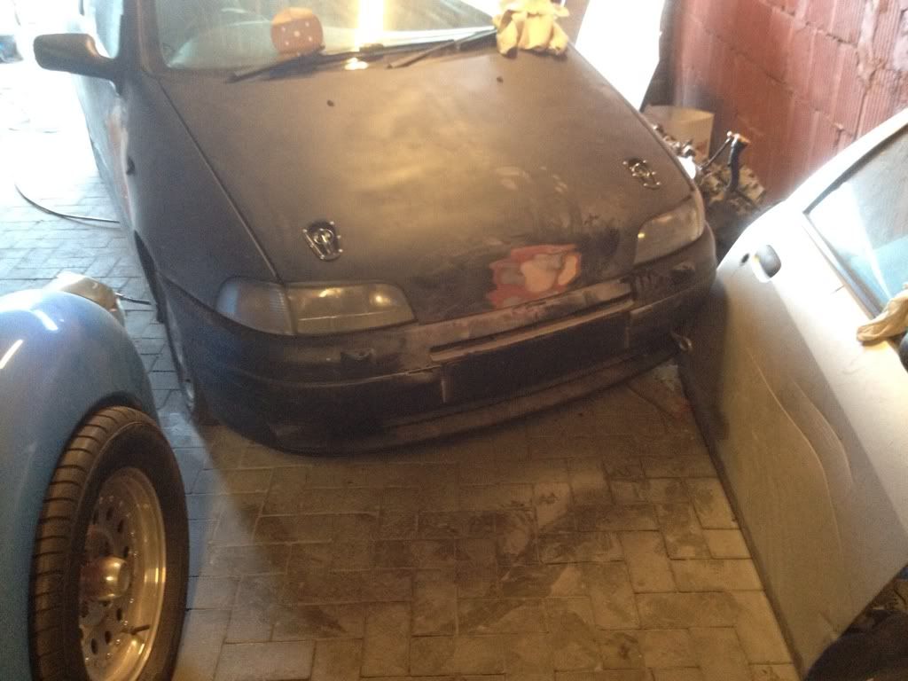

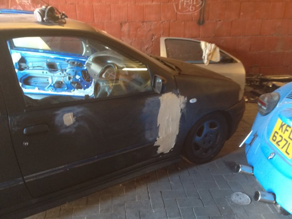

The little beast was in bad shape the slave cylinder had a very bed leak
The release bearing in the gear box was snapped in half the cluch was dead
The shell was covered in damage and the floor was rusted to hell
I got the car back to my work and started work straight away

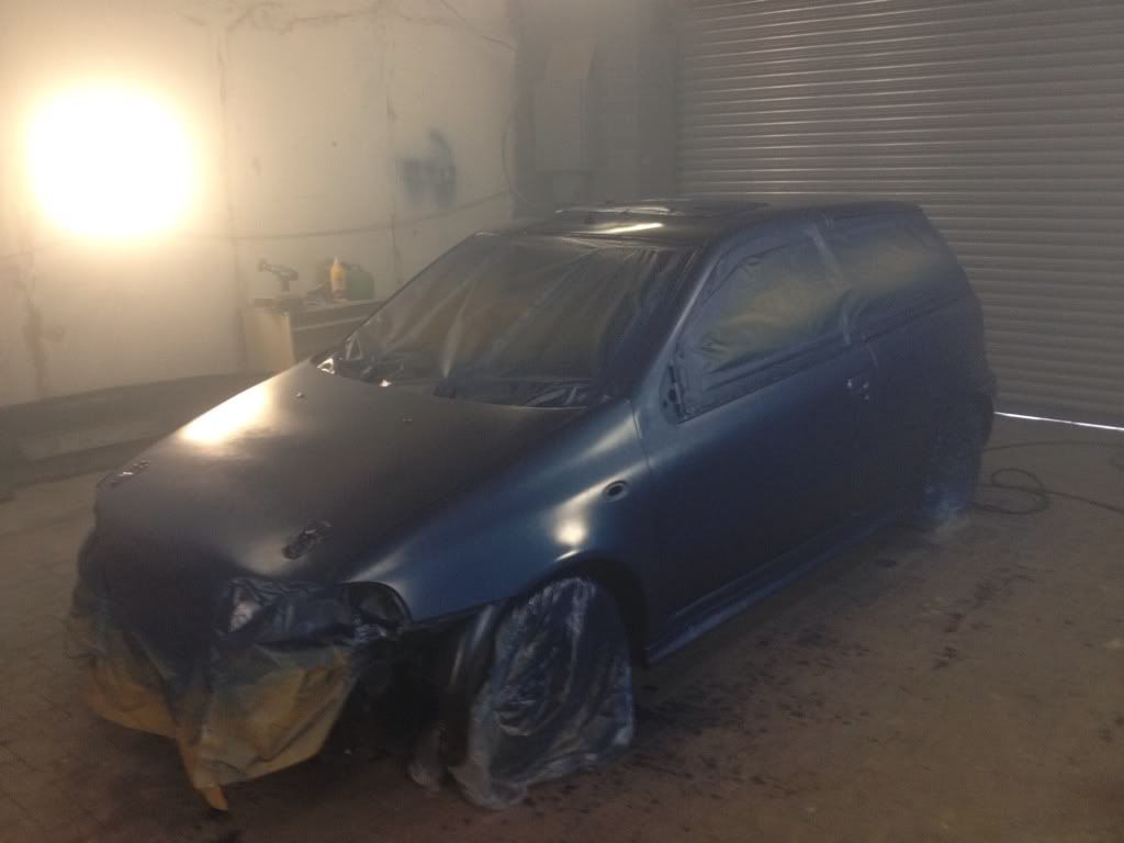

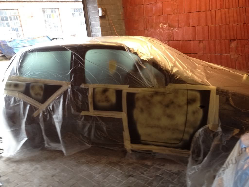

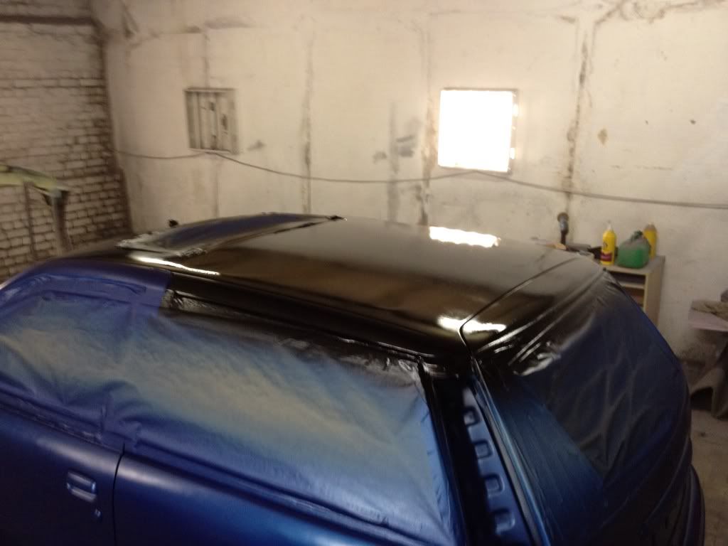

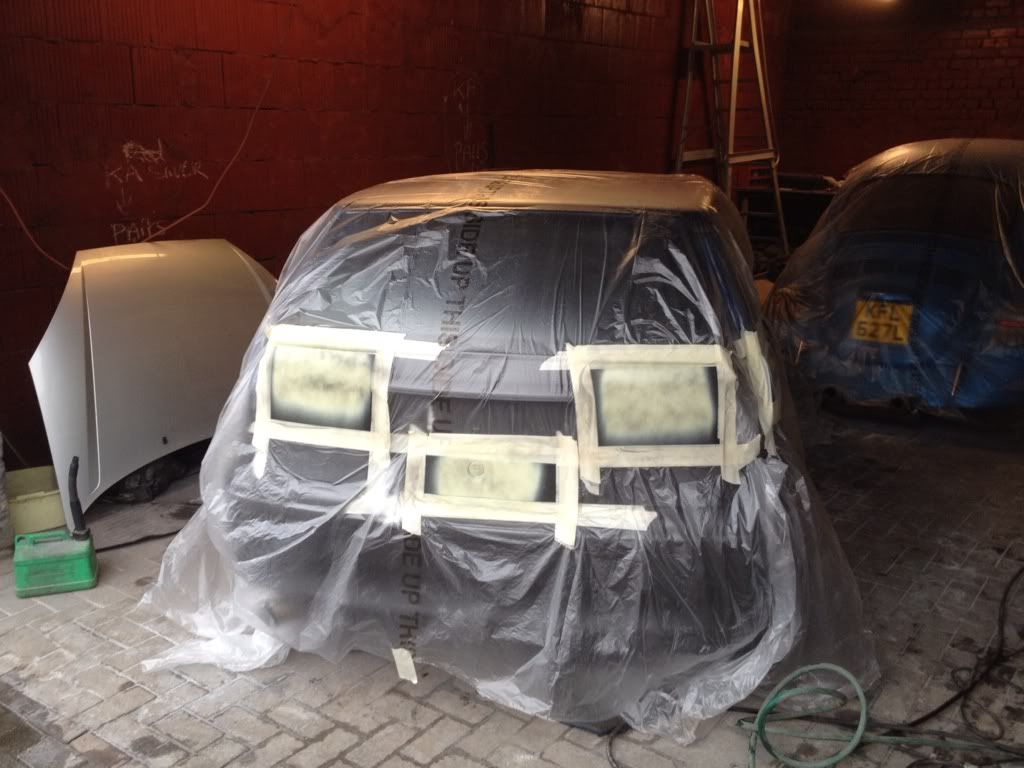

I got the car ready for a full respray back to the stranded color but with abut if a difference lol
PuntoGT project  4e6543a9
PuntoGT project  F48bb705
PuntoGT project  0bf43673
PuntoGT project  C75f6782

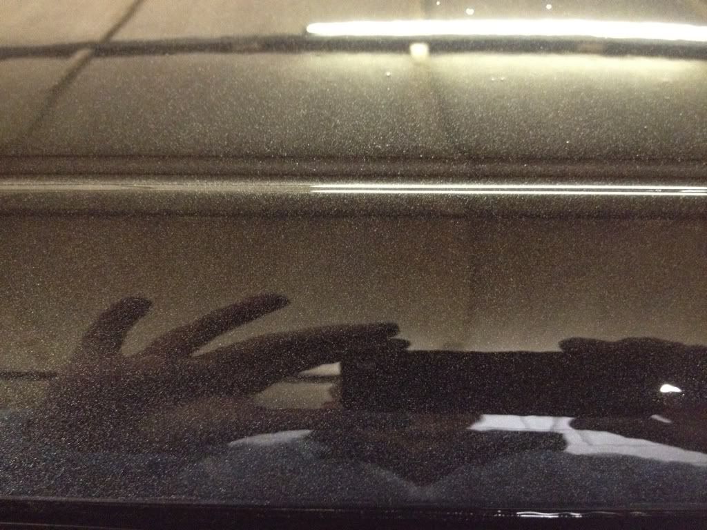

I ended up puting some silver paint into the lachura to make it more matalic
PuntoGT project  F9db4508
PuntoGT project  35e82918
PuntoGT project  Ee4feb05
I did ll the repairs and got all the welding done that cost me £170
And replaced the slave cylinder and releace bearing and put a new cluch in the car

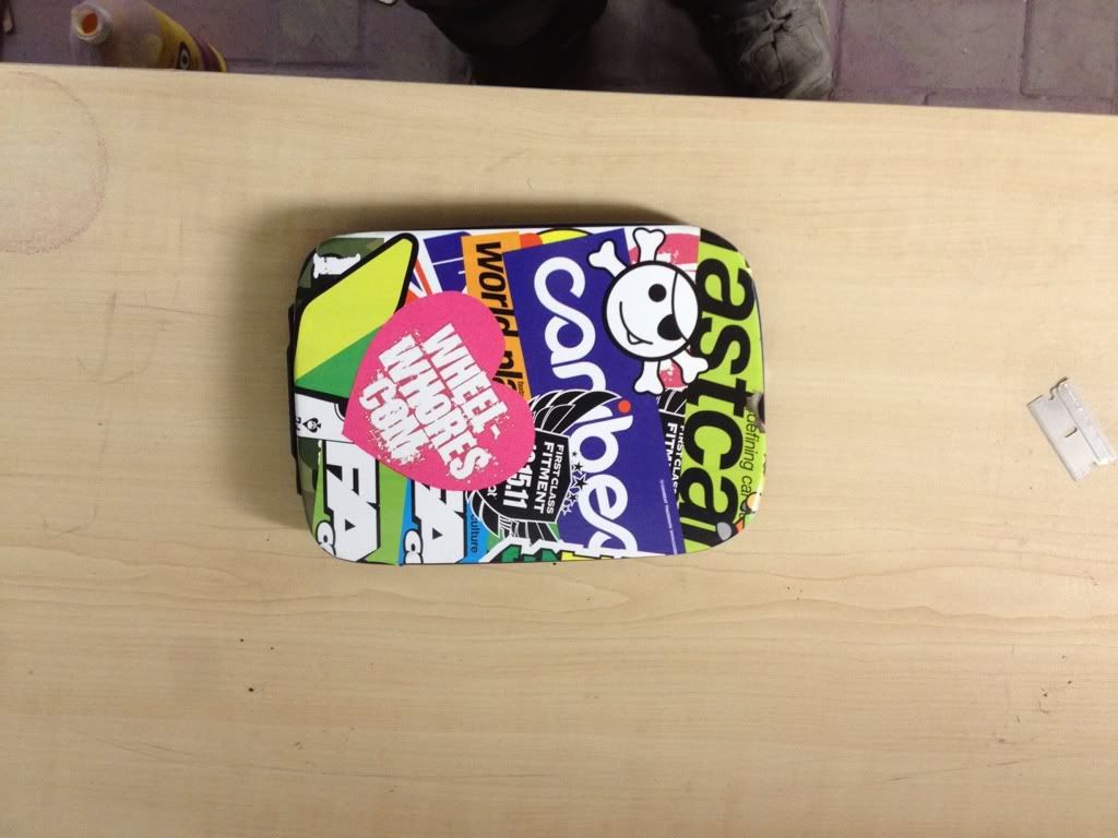

I sticker bombed the petrol cap aswell

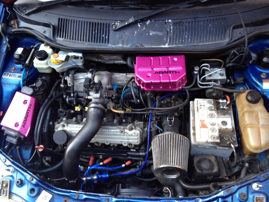

And now it's gone through a few different changes lol with a new front mount intercooler
New air filter all the Interier stripped out
And a few other bits and bobs

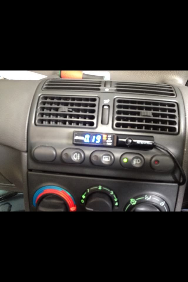

Added an apexi turbo timer aswell

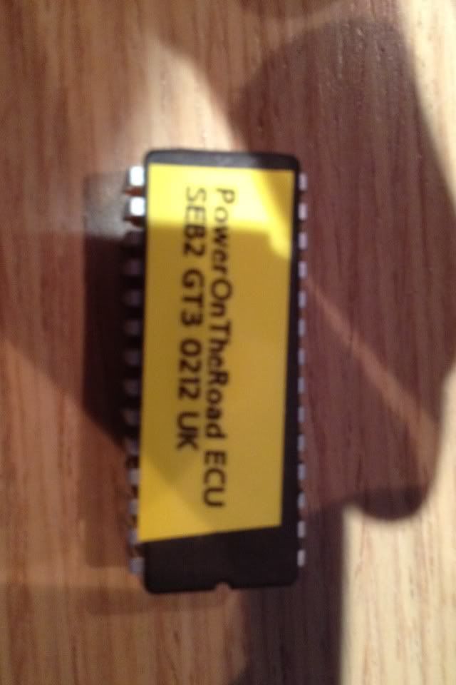

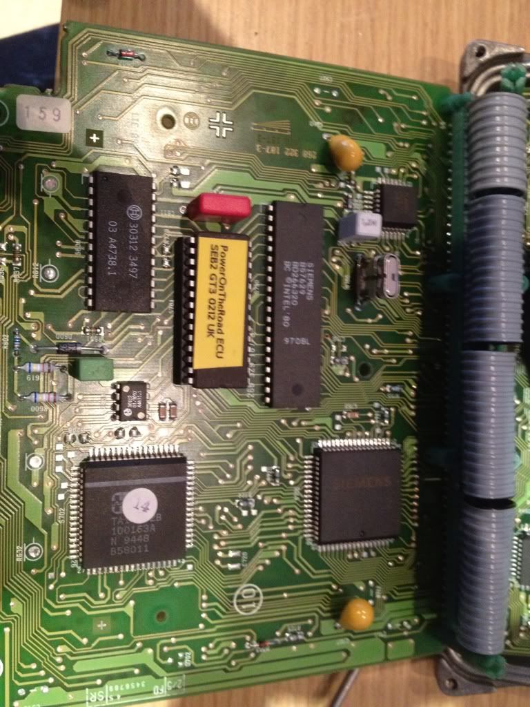

SEB chip came today Very Happy it's a 170 bhp chip
PuntoGT project  716d102c
PuntoGT project  F381b590
Fitted the chip my self just got to take it on a test drive now

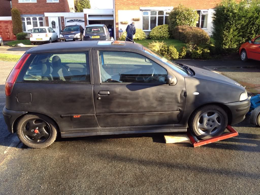

Painted the alloys white today

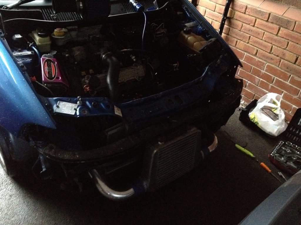

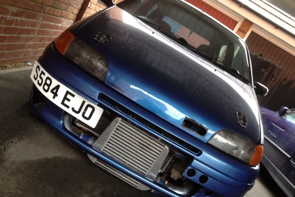

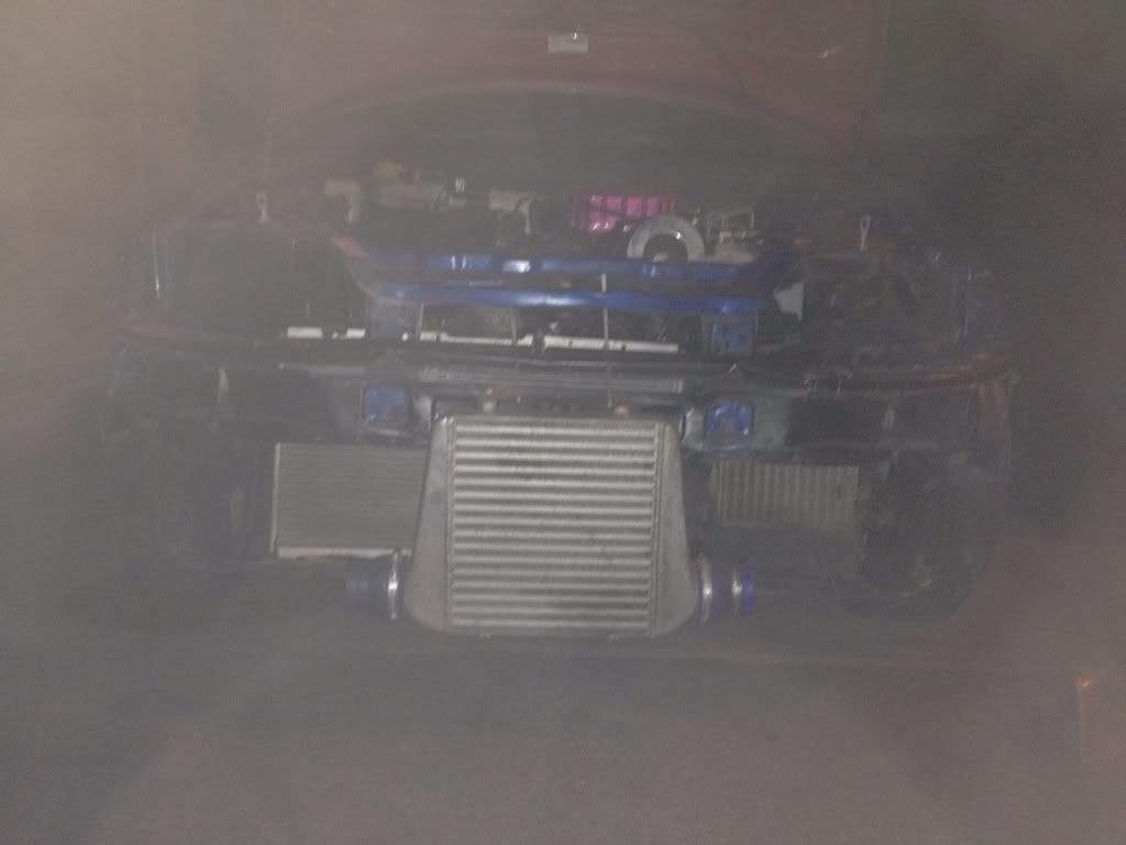

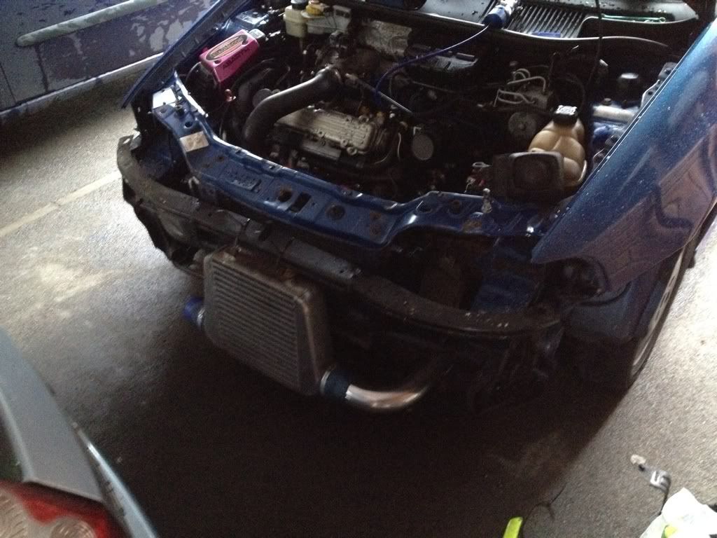

Got a massive front mount
PuntoGT project  7aeea55b
PuntoGT project  A4320fb7
PuntoGT project  73711b37
I wasnt happy with what I did at all so I had a think with Shrek and we can up with this Very Happy
PuntoGT project  Cd4cd254
Ha ha sleeper GT got a smaller front mount and it's works incredibly amazing
I and I got giddy with paint and painted my rocker cover aswell

Nice one mate, rocker looks rate good Very Happy now u just need to tweek that bumper a little, move filter to front, paint it and your sorted Wink now u need decent timing belt etc, then we can crank up the boost and fuel pressure alien
